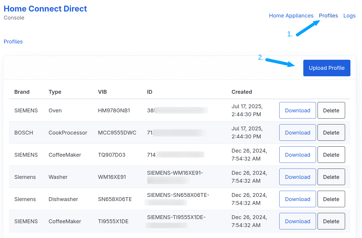

# Load Appliance Profiles
The binding includes a dedicated web console for profile management.
  1. Access the Console: Open your browser and navigate to:
    http(s)://[YOUR_OPENHAB_IP]:[PORT]/homeconnectdirect
    (e.g., http://192.168.178.100:8080/homeconnectdirect)
  2. Go to Appliance Profiles: Open the "Profiles" menu item.
  3. Upload Profiles: Click the Upload Profile button in the top-right corner.
IMPORTANT: The binding cannot fetch profiles automatically from the BSH cloud. You must use an external tool to download your profiles first.
Recommended Tool: HomeConnect Profile Downloader (opens new window)
Download the latest version from the Releases page (opens new window).
Home Connect Direct Console - Profile UI

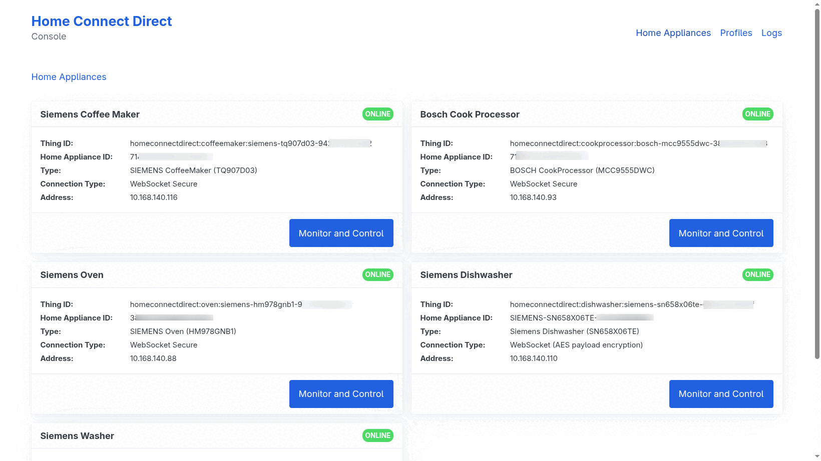

# Discovery & Configuration
# Creating Things
Once profiles are uploaded, you can add your appliances:
  • Automatic Discovery: The binding uses mDNS to scan your local network. Discovered devices will appear in the openHAB Inbox automatically.
  • Manual Configuration: You can manually create things via the UI or .things files using the parameters below.

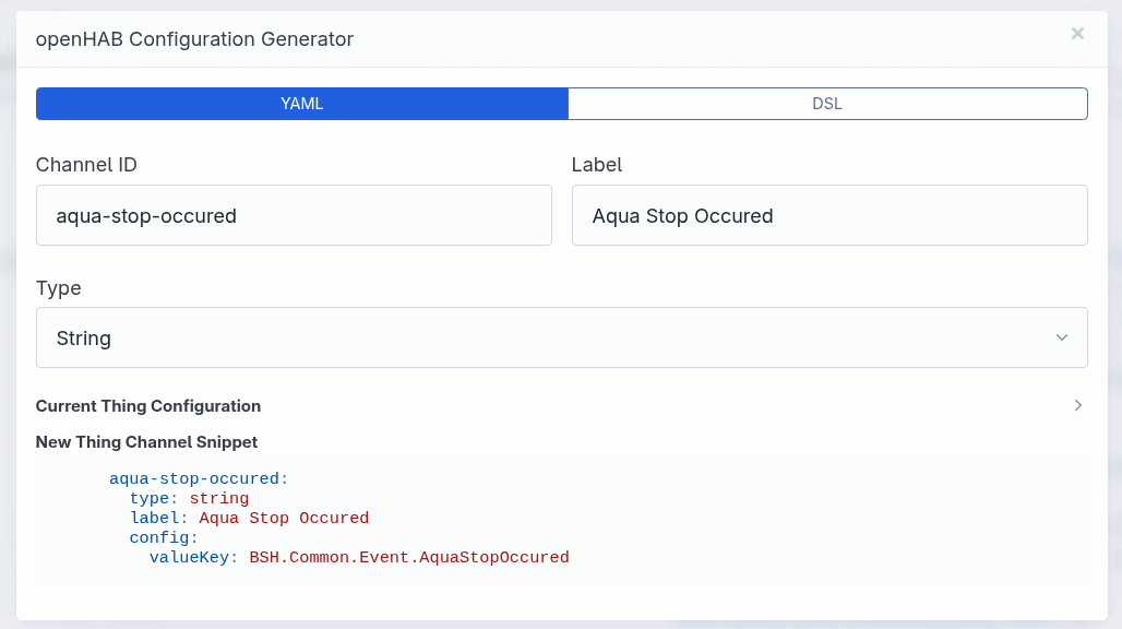

Custom channels allow you to monitor any internal value or device description attribute available in the appliance profile. This is useful for advanced scenarios or accessing functions not covered by standard channels.
The binding's web console includes an openHAB Configuration Generator to help create the necessary YAML or DSL for these channels. You can access it by monitoring an appliance and clicking the openHAB icon next to any value or description key.

The binding includes a built-in web console (accessible at http://[YOUR_OPENHAB_IP]:[PORT]/homeconnectdirect) that serves as a powerful tool for setup, monitoring and troubleshooting.
# Main Sections
  • Home Appliances: Lists all discovered and configured appliances. It provides a quick overview of their connection status (ONLINE/OFFLINE), hardware details (Brand, Type, VIB), and local network addresses.
  • Profiles: Central management for Appliance Profiles. Here you can upload new profiles (required for initial setup), download existing ones for backup, or delete outdated profiles.
  • Logs: Allows management of message logs stored on the openHAB server. You can import external logs (e.g., from HomeCap (opens new window) or the Home Connect Appliance Proxy (opens new window)), download logs for analysis or view them directly in the browser.
Home Appliances UI

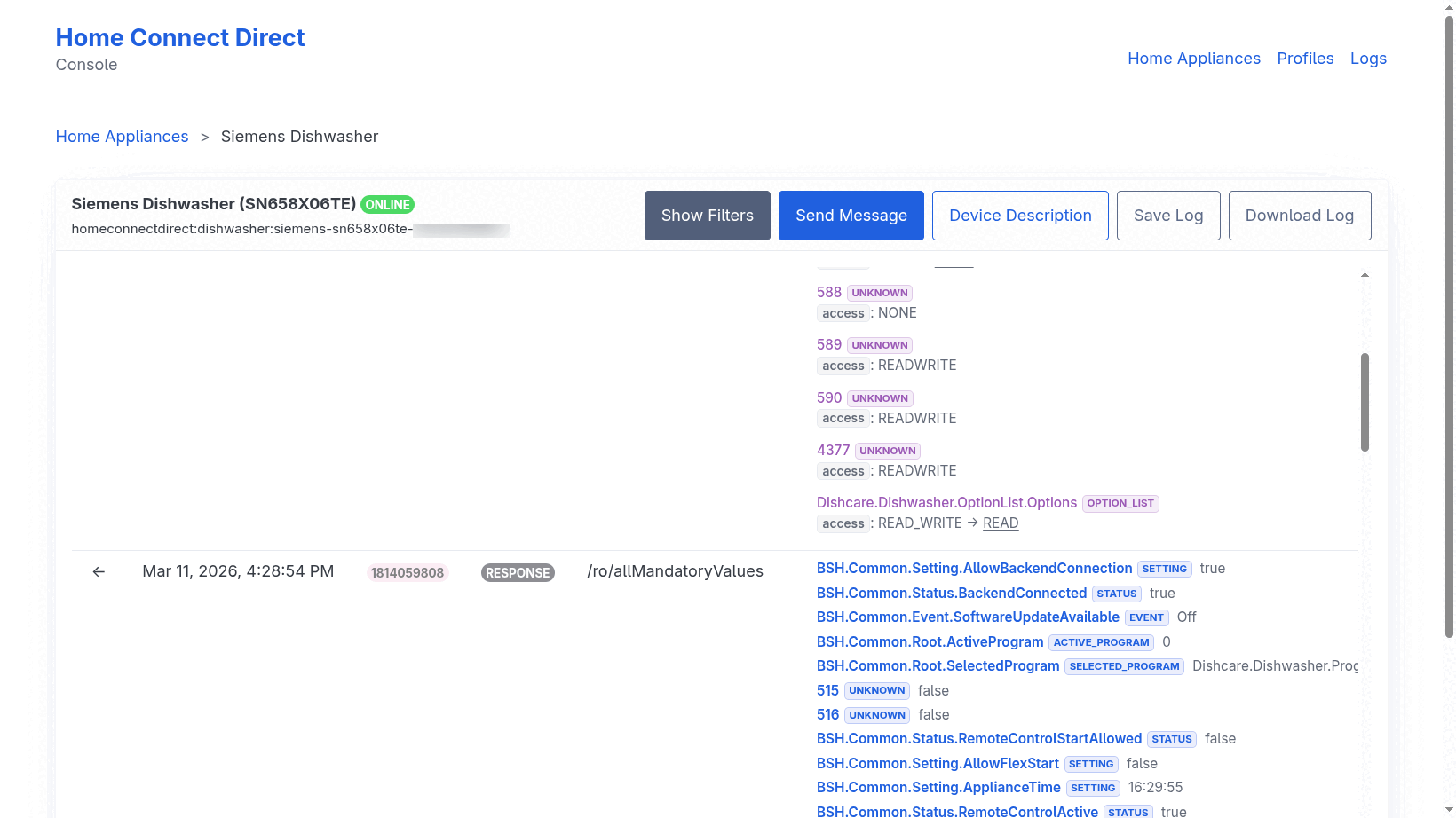

# Monitoring and Control
By clicking "Monitor and Control" on an appliance, you enter a real-time diagnostic view:
  • Live Message Stream: View every message exchanged between openHAB and the appliance in real-time via WebSockets.
  • Advanced Filtering: Narrow down the message stream by value keys, description keys, resource paths, actions (GET/POST/NOTIFY), or specific time ranges.
  • Deep Inspection: Click on any message to view its raw JSON payload, formatted values, or device description changes. You can also browse the internal Device Description tree.
  • openHAB Configuration Generator: Next to each value or description attribute, you'll find an openHAB icon. Clicking it opens a generator that provides ready-to-use YAML or DSL snippets for creating custom channels (see Custom Channels).
  • Raw Messaging: Send manual GET, POST, or NOTIFY commands directly to the appliance for testing and advanced control.
Monitor and Control UI Monitor and Control UI - openHAB Configuration Generator
