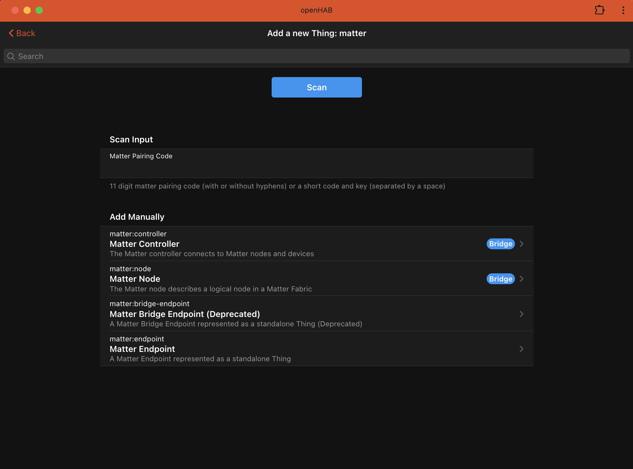

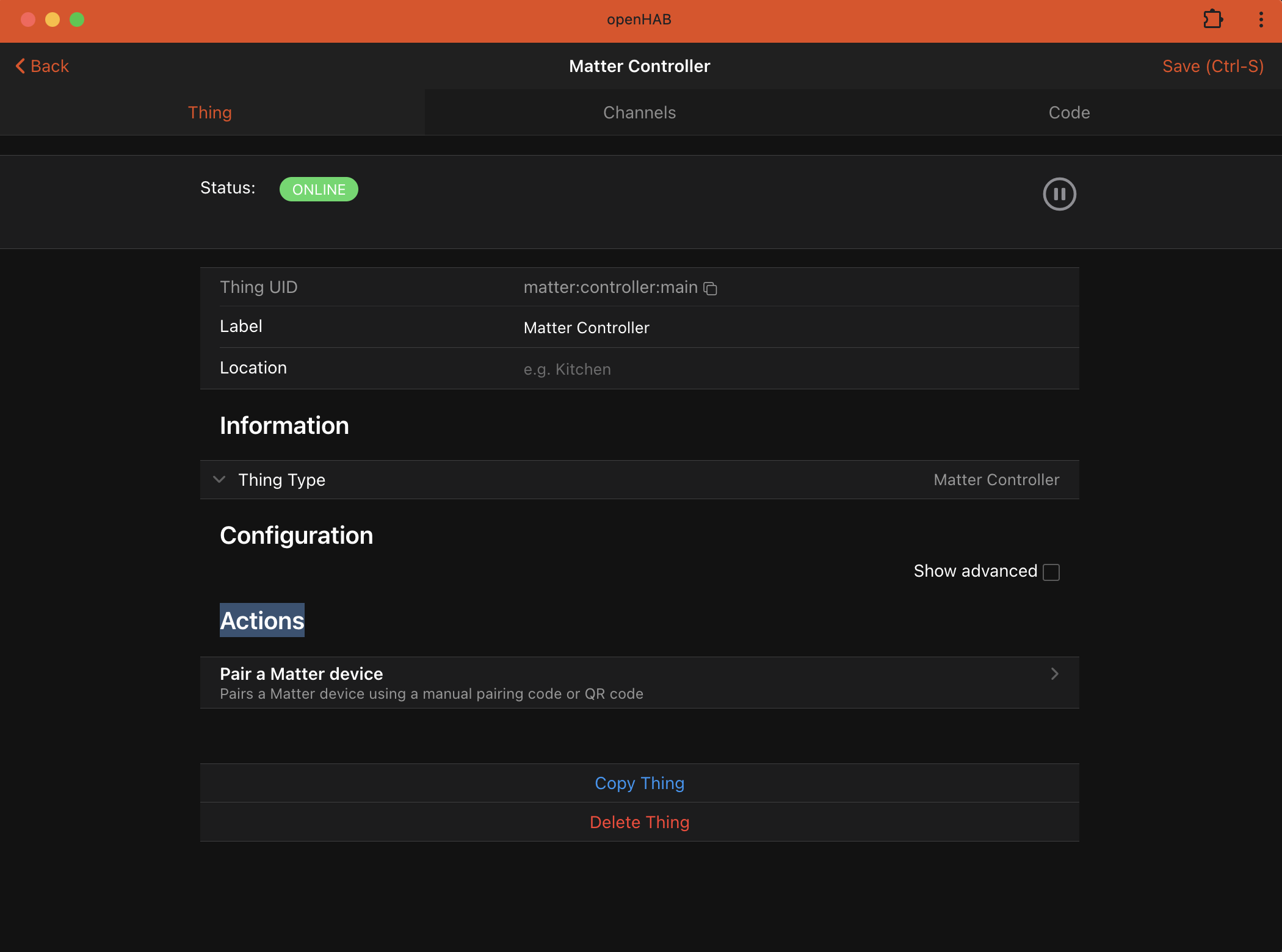

# Device Pairing: General
The pairing action can be found in the settings of the "Controller" Thing under the "Actions" -> "Pair Matter Device"
This action will give feedback on the pairing process, if successful a device will be added to the Inbox.
See Device Pairing: Code Types for more information on pairing codes and code formats.
The same codes can also be used in the openHAB Thing discovery UI, although feedback is limited and only a single controller is supported.

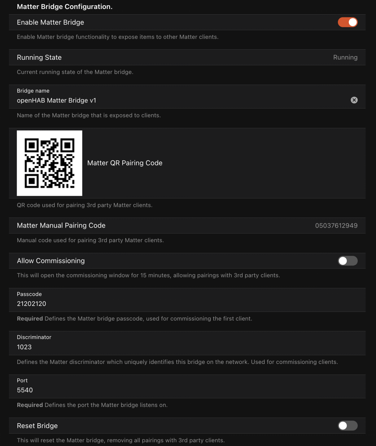

# Configuration
Note: The openHAB Matter bridge is unrelated to the Matter Controller Thing. Adding, modifying or removing a Matter "Controller" Thing, or any Matter "Node" Thing will have no affect on the bridge.
There are two ways in which to configure the Matter bridge:
- Using the "Matter Bridge Configuration" settings page (Main UI -> Settings -> Add-on Settings -> Matter Binding) for bridge status, general configuration and pairing 3rd party clients.
- Adding Matter metadata tags to Groups and Items either through the Main UI or through item files.

If there are issues starting the bridge, check the status field in the bridge settings page to see if there are any errors.

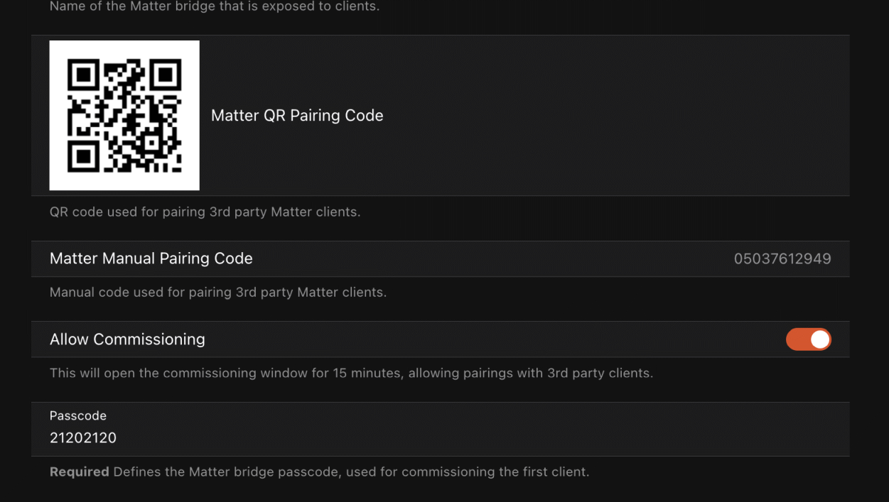

# Pairing 3rd Party Clients
Pairing codes and other options can be found in the MainUI under "Settings -> Add-on Settings -> Matter Binding"
When the matter bridge starts, if no 3rd party clients are paired, it will automatically open the "Commissioning Window", meaning you can use the QR code or manual pair code found in the bridge settings page to pair a new client like Alexa, Google Home or Apple Home.
Once a client is paired, the bridge will default to having its "Commissioning Window" closed and can not be paired with until the window is opened again in the settings.
To pair additional clients, you can open the commissioning window again in the settings by enabling "Allow Commissioning", clicking save, and then and pair a new client within the 15 minute window using the QR code or manual pair code.
Once a new client is paired, or the 15 minute window expires, the bridge will default to having its "Commissioning Window" closed and can not be paired with until the window is opened again in the settings.
# Resetting the Bridge
If you need to reset the bridge, you can do so by enabling the "Reset Bridge" button in the bridge settings page (advanced options) and clicking save.
Note that this will leave 3rd party clients paired to the bridge still in a "paired" state, and you will need to unpair the now orphaned openHAB Matter bridge in their respective apps.
Resetting the bridge is almost never needed, and should only be used if advised to do so by a developer.

# Matter Commissioning and Pairing Codes
Commissioning a Matter device involves securely adding it to the network using a pairing code. This process ensures that only authorized devices can join the network.
# Pairing Code from the Device
When commissioning a new Matter device, it typically has a printed QR code or numeric pairing code that you scan or enter during setup. This pairing code allows the controller to establish a secure connection to the device and add it to the network. Once a device pairing code is in use, it typically can not be used again to pair other controllers.
# Additional Pairing Code from a Controller
If a device has already been commissioned and you want to add it to another Matter controller, the existing controller can generate an additional pairing code. This is useful when sharing access to a device across multiple hubs or apps. Apple Home, Google Home, Amazon Alexa and openHAB all support generating pairing codes for existing paired devices.
# Example:
- When setting up a smart lock, you may scan a QR code directly from the lock, or use the 11 digit pairing code printed on it to pair it with openHAB.
- If you later want to control the lock from another app or hub, you would retrieve a new pairing code directly from openHAB.
