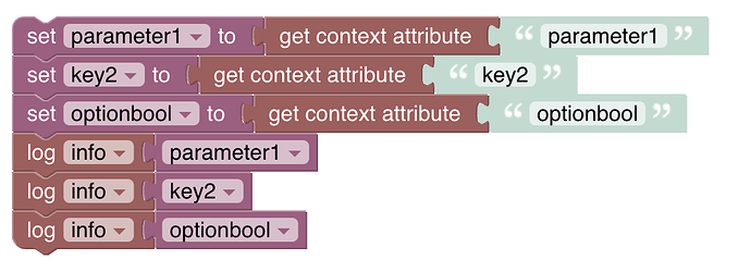

# Retrieve context attribute from rule
Function: Retrieve context attributes passed by a calling rule/script (see above)
This retrieves the value for the key "myKey1" that was passed by the calling rule.
