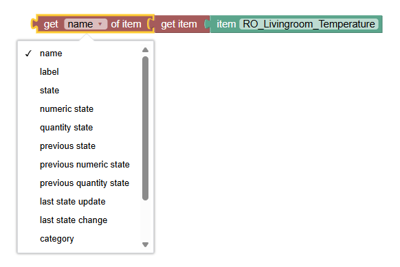

# Get particular attributes of an item
blockly-getItemAttributes
Function: Get either the current name, label, state, category, tags, groups, or type of an item as a String
It requires an item object to be connected.
These attributes are returned with the following types:
  • name: String
  • label: String
  • state: State
  • numeric state: Number
  • quantity state: Quantity
  • category: String
  • tags: Array, e.g.
[plannedTimes]
  • groups: Array, e.g.
[plannedTimes, timers]
  • type: String
blockly-getItemAttributes-fix
Special handling for Arrays
The attributes groups and tags return an Array of entries. Therefore
  • they cannot be connected to a block that expects a String (e.g. log-block)
  • they must be handled using a for-loop as follows
blockly-specialArrayHandling
