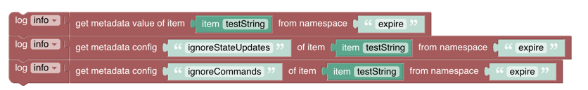

# Item Metadata
The metadata blocks provide an easy way of accessing namespace metadata information both for reading and writing. Accessing config metadata on hierarchical levels as well as variable support that allows iteration over computed names is supported (see the examples below).
Note: Metadata blocks are not available for Nashorn but only for GraalJS / JS Scripting.
Here is an expire metadata definition which is visualized as
and modelled in YAML as
value: 0h3m0s
ignoreStateUpdates: "true"
ignoreCommands: "true"
with the blocks that can access it:
![blockly-metadata](../images/blockly/blockly-metadata.png)
There a two different type of blocks:
The value block is the main one for the _value_ of the namespace, which is also directly shown in the MainUI's list of an item's metadata, while the _config_ part holds more complex configuration of that metadata structure below the entry _config_.
The following blocks allow to _change_ the config values in the namespace _expire_:
![blockly-metadata-change](../images/blockly/blockly-metadata-change.png)
