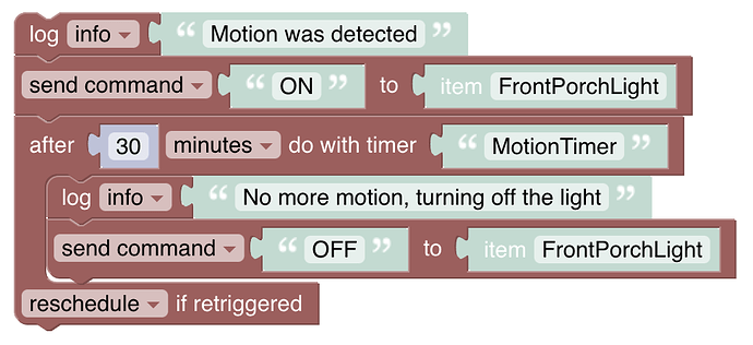

Now let's work on what we want to have happen when the rule triggers. As mentioned above we want to turn the light on and leave it on until thirty minutes after the last motion is detected.
First create a new Action and choose Script Action and Design with Blockly.
To start, we want to be able to see that this rule is running.
So we will first add a log statement which you will find in the openHAB -> Logging & Output section.
We will choose "info" for the level and type a message we want to see in openhab.log when this action is executed.
Next we want to command a light to turn ON. Under openHAB -> Items & Things you'll find a "send command" block.
Drag that over and dock it under the log statement.
We want to send ON to the Porch Light Item.
If the light is already ON nothing will happen but, if your device behaves differently you might need to check to see if the light is already ON before sending the command.
Next we want to set a timer. A timer is a way to schedule some code to run later on. The rule will continue and exist after the timer is created (i.e. it doesn't wait around) and the timer will execute in the background at the scheduled time.
In this case we want to wait thirty minutes. But we want to wait for thirty minutes after the last motion. This rule gets triggered every time motion is detected so we need to reschedule the timer every time motion is detected. A reschedule will tell the timer to run at a different time. Only when there has been thirty minutes of no motion will the blocks inside the Timer block be executed.
Under openHAB -> Timers & Delays drag the "after" block that includes "reschedule" at the bottom. We need to change the time to thirty minutes. Notice the little triangle next to "seconds". Clicking on that will bring up a list of options to choose from. Anywhere you see that triangle there are options (e.g. clicking on "info" for the log can change the logging level, clicking on "send command" lets you change to "post update").
Give the Timer a meaningful name. It's good to be in the habit of naming everything with a meaningful human readable name.
Now we need to add the block to run thirty minutes after the last motion was detected. We want to send an OFF command to the light. But, for testing and debugging we also want to log something out so add a log statement too.
Trigger the rule a few times and watch the logs to make sure you see the commands and logging events as expected. When testing, consider using a smaller timer time (e.g. three seconds) and change back to the desired time once you know it is working.
