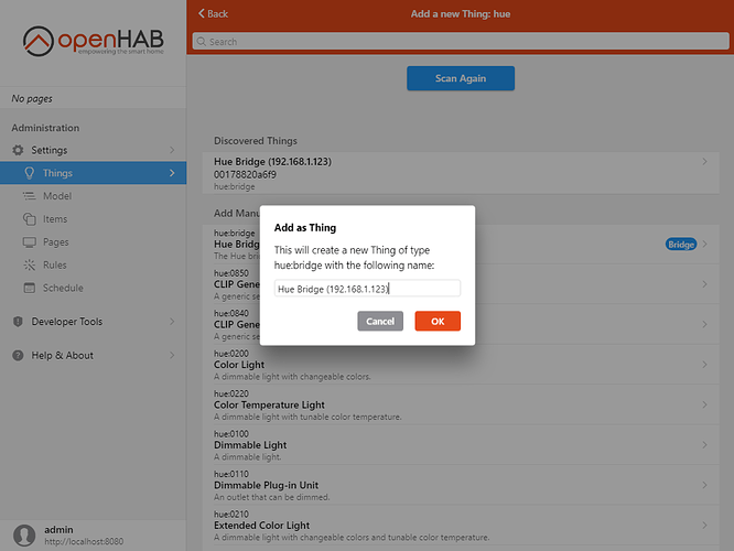

Click on the discovered Hue Bridge.
add hue bridge
openHAB will ask you to confirm or change the label/name. Click OK after naming the new Thing.

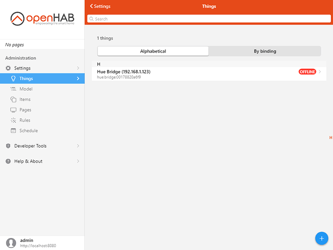

You will be taken back to the Things page, where the Hue Bridge should now appear.
hue bridge offline
However, we can see that it's marked offline. To find out why we can click on the Hue Bridge.
hue bridge config error
The error description below the status gives some more information: You have to press the physical button on the device to let openHAB authenticate to it. Once you've done this, the Thing will become online.
