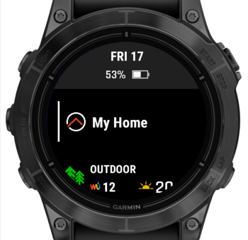

# Introduction
This app is built on the foundation of openHAB sitemaps, which define an interactive view of your openHAB model. A sitemap allows you to specify which devices are accessible through the app and how they are organized and presented.
The app consists of two components: the Glance and the Widget. The Glance displays the name of the sitemap and acts as the entry point into the full-screen Widget, which shows the sitemap's content.
Once opened, the Widget polls the sitemap at a configurable interval to fetch updates. Commands are sent to openHAB via its JSON-based REST API. If your openHAB setup does not support this API, you can alternatively configure a custom Webhook.
Inside the Widget, sitemap elements are displayed as Sitemap Widgets.

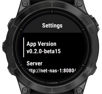

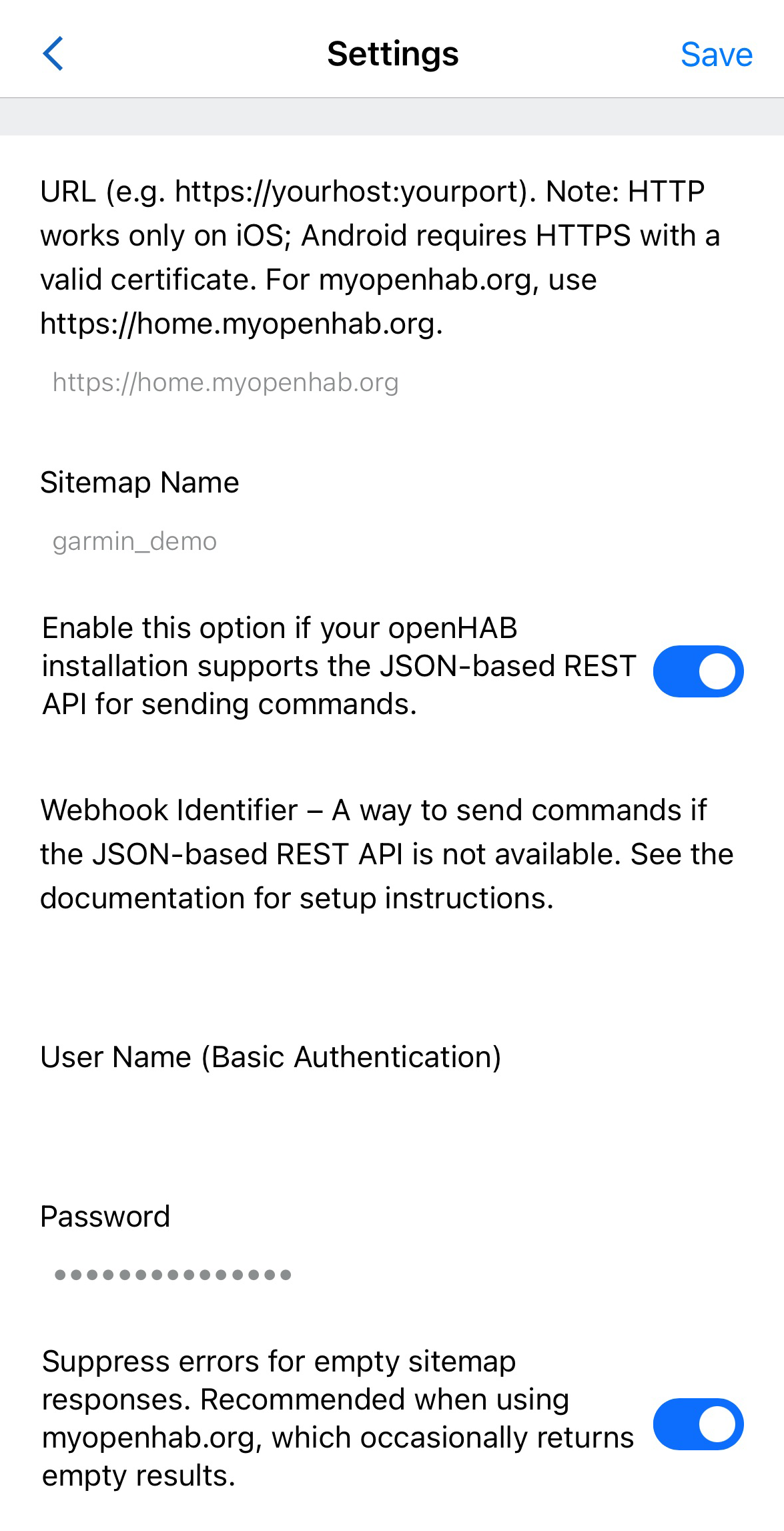

# Configuration
Once the app is installed, you can configure the following settings by opening it in the Garmin Connect IQ smartphone app.
Setting Description
URL Your openHAB URL in the format https://host:port or http://host:port. Note: HTTP only works with iOS. See Connectivity and Using myopenHAB for details.
Sitemap Name Name of the sitemap to display. See Sitemap Setup for details.
Native REST API Support Enable if your openHAB supports the new JSON-based REST API for sending commands. See Sending Commands for details.
Webhook Identifier If your openHAB version doesn't support the JSON-based REST API (see above), you can configure a custom webhook to send commands. See Sending Commands for details.
Username For basic authentication (used for myopenHAB, see below)
Password Password for basic authentication
Supress empty response errors Suppress errors for empty sitemap responses. Recommended when using myopenhab.org (opens new window), which occasionally returns empty results. See the related openhab-cloud issue #496 (opens new window) for details.
Polling Interval (ms) Interval between data requests to your openHAB instance. Set to 0 to fetch new data immediately after the previous response is processed. Polling only occurs while the app is open, not in the background. If you're using myopenhab.org (opens new window), it's recommended to use the default (3000 ms) or a higher value to avoid overloading their servers. If you're connecting to your own openHAB server directly, you may try setting it to 0 for more responsive updates.
App Settings

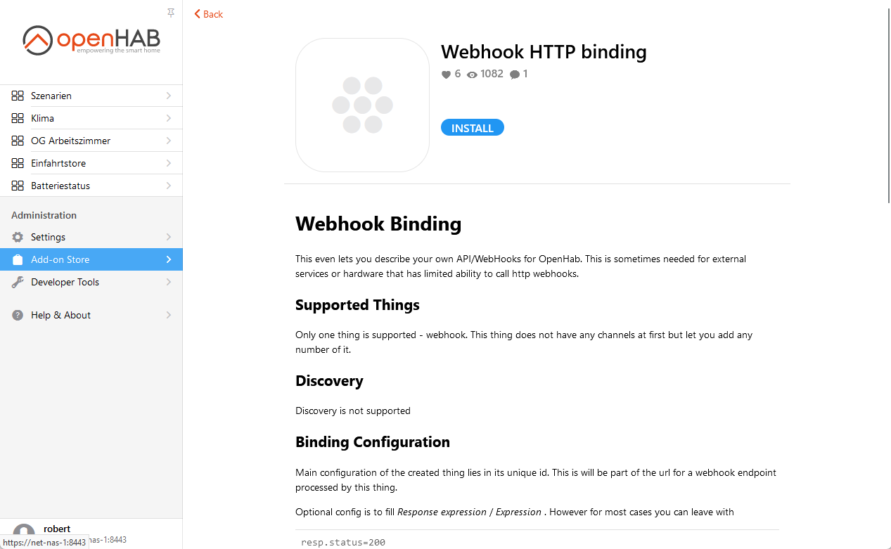

# 1. Install the Webhook Binding
Install the Webhook HTTP binding (opens new window).
Web Hook Installation

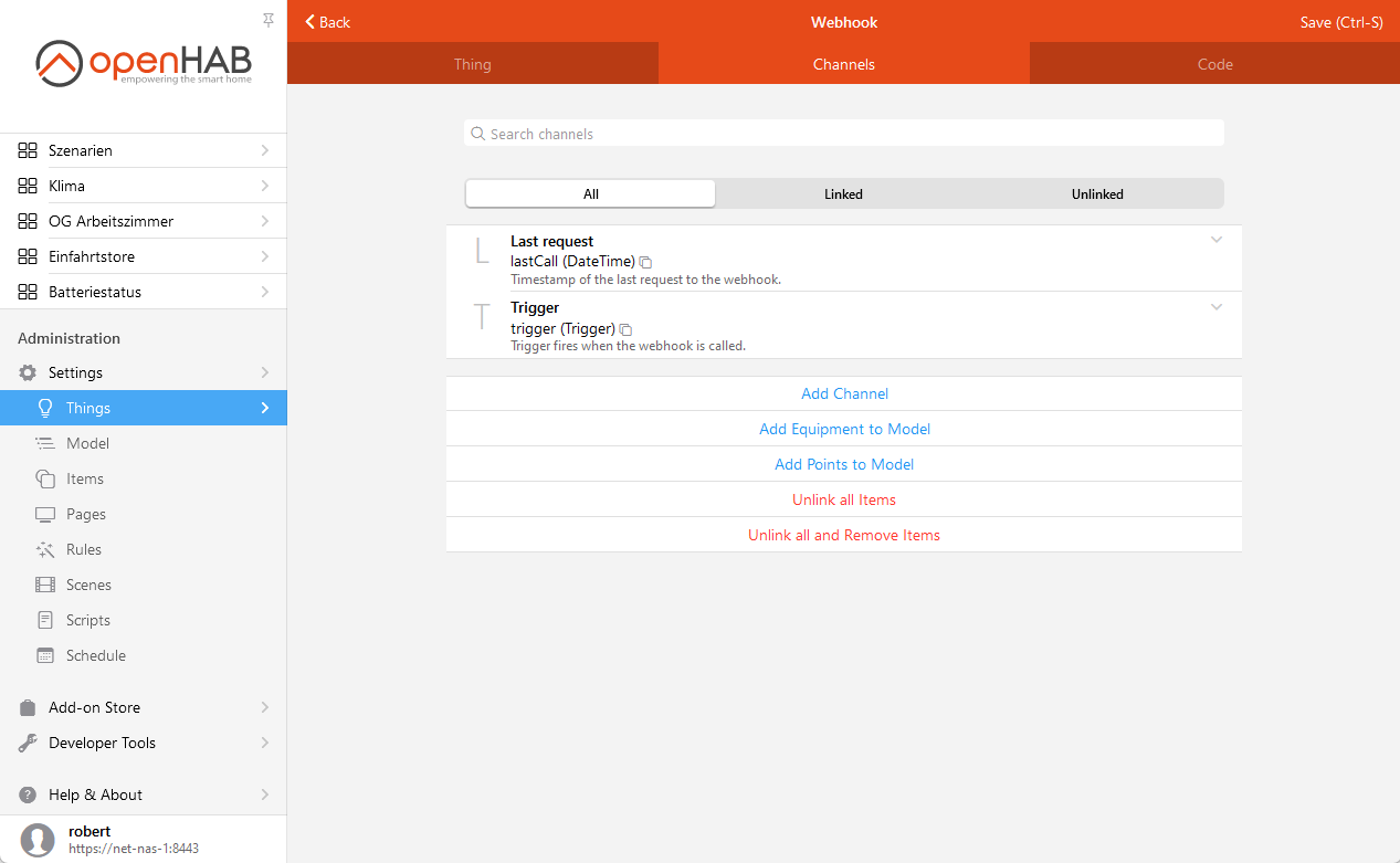

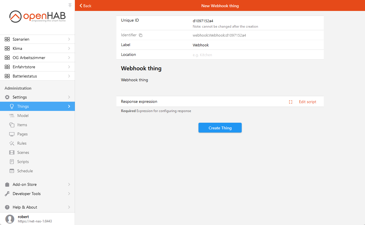

# 2. Create a Webhook Thing
Create a new Webhook Thing.
Thing Creation
Go to the Code tab and enter the following YAML (replace UID with your own):
UID: webhook:Webhook:d1097152a4
label: Webhook
thingTypeUID: webhook:Webhook
configuration:
  expression: resp.status=200
channels:
  - id: lastCall
    channelTypeUID: webhook:lastCall-channel
    label: Last request
    configuration: {}
  - id: trigger
    channelTypeUID: webhook:trigger-channel
    label: Trigger
    configuration:
      expression: >-
          var gson = new("com.google.gson.Gson");
          var jsonRoot = {:}; var jsonBody = {:};
          if (!empty(req.body.text)) jsonBody.put("text", req.body.text);
          if (!empty(req.body.json)) jsonBody.put("json", req.body.json);
          jsonRoot.put("parameters", req.parameters);
          jsonRoot.put("body", jsonBody);
          jsonRoot.put("method", req.method);
          return gson.toJson(jsonRoot);
Thing Channels

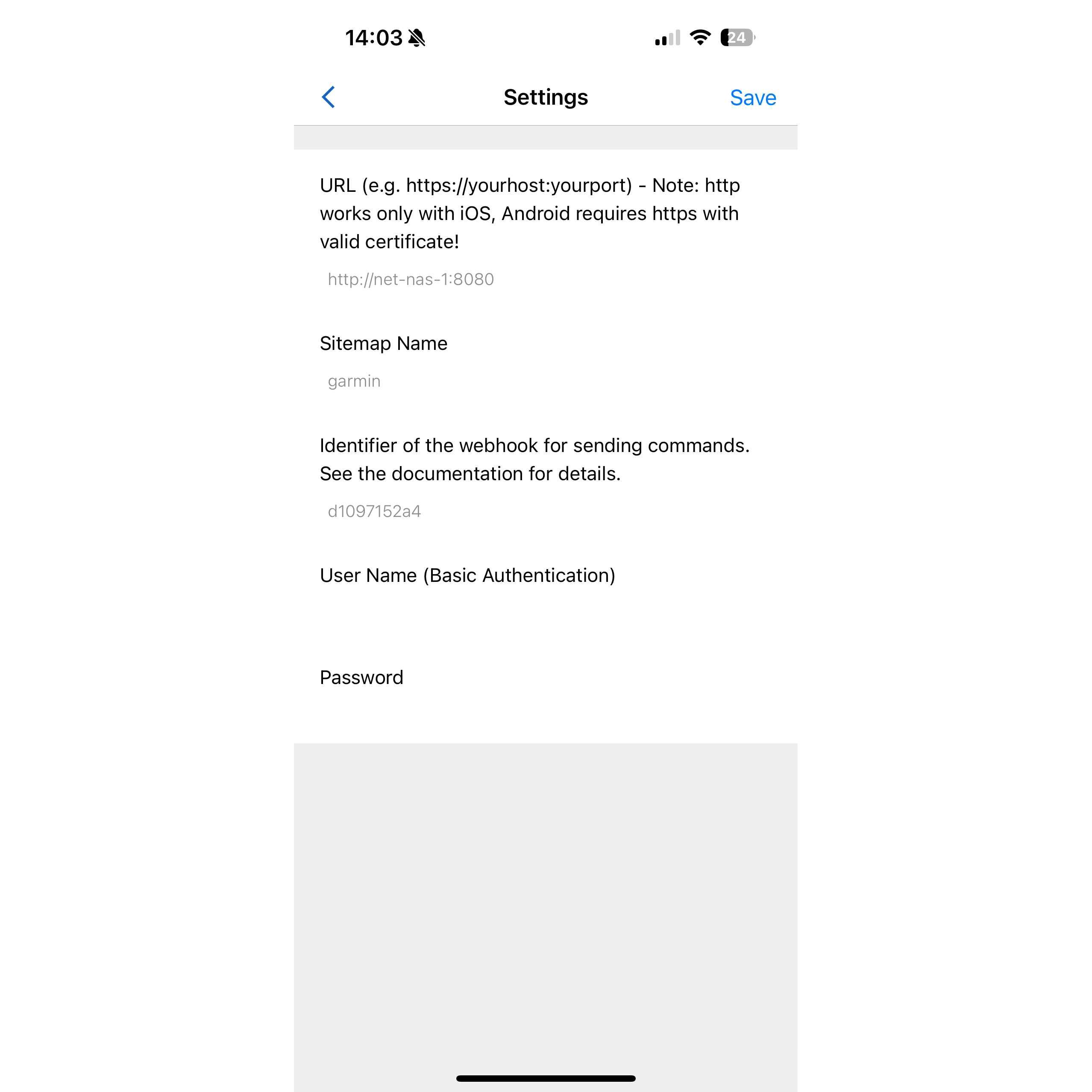

# 4. Test & Connect
You can test the webhook by visiting:
https://yourserver:yourport/webhook/d1097152a4?action=toggle&itemName=LightBedroom
Then enter the Webhook ID (d1097152a4) in the app settings:
App Settings: Webhook

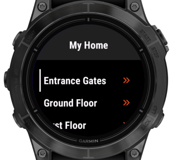

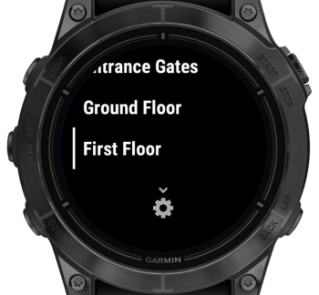

# Frame
The ➡️ Frame element is one of three sitemap elements that support hierarchical structuring.
You can nest Frame elements within other Frame elements. While this is allowed by the specification, openHAB may log a warning when doing so — but it still functions as expected.
Technically, the specification does not permit mixing Frame elements alongside other element types at the same hierarchy level. However, in practice, this does work in openHAB. If you choose to use this unsupported approach, be aware that you're doing so at your own risk.
Here is an example of a sitemap containing three Frame elements.
sitemap garmin_demo label="My Home" {
 Frame label="Entrance Gates" {
  Switch item=EntranceGatesTrigger label="Open/Close" mappings=[OFF="", ON="OK"]
  Text item=EntranceGateStatus label="Status"
 Frame label="Ground Floor" {
 Frame label="First Floor" {
This configuration produces the following display in the UI:

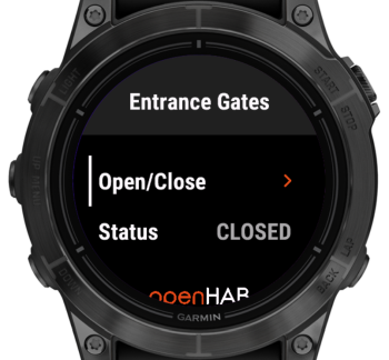

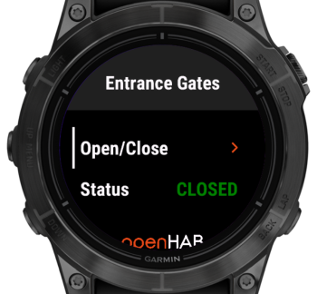

# Text
The ➡️ Text Sitemap Widget is used to display the current state of an item without allowing any user interaction.
Supported parameters:
  • label: the label shown in the UI.
  • item: the name of the openHAB item whose state should be displayed.
This widget is ideal for showing read-only information, such as temperature, system status, or sensor readings. It also supports nested elements, making it suitable for creating a hierarchical sitemap structure.
Example configuration:
In this example, the Text Sitemap Widget is used to display the status of entrance gates. Triggering the gates is handled by a separate Switch element.
  Switch item=EntranceGatesTrigger label="Open/Close" mappings=[OFF="GO", ON="DONE"]
Resulting UI:

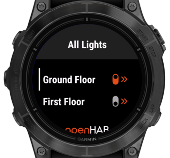

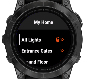

# Group
The ➡️ Group Sitemap Widget will present a submenu containing all the items in the associated item of type Group. This also works recursively, if the Group item itself contains other Group items, those will again open their own submenus.
In this example, the CC_House_Lights item represents a hierarchical structure: it contains groups for each floor (e.g., the first floor), which in turn contain groups for individual rooms, and those room groups include the actual light switch items.
 Group item=CC_House_Lights label="All Lights"
Resulting UI:

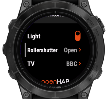

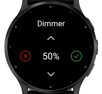

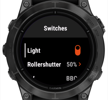

# Toggle Switch
This is the default behavior when:
  • No mappings are provided,
  • The item has no command descriptions,
  • The item is not of type Rollershutter.
The switch simply toggles between ON and OFF.
Note: If an item of type Dimmer is linked to a Switch and no state mappings are defined, a toggle switch will be displayed. The toggle will send ON and OFF commands. For display purposes, a Dimmer state of 0 is treated as OFF, while any value from 1 to 100 is considered ON.
Example:
Frame label="Switches" {
    Switch item=Light label="Light"
UI Preview:

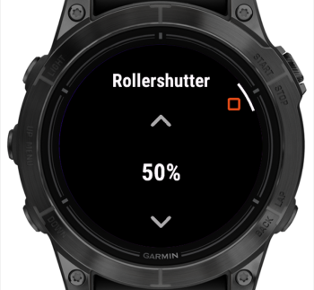

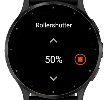

# Rollershutter
When the item type is Rollershutter, the widget opens a full-screen control with UP, DOWN, and STOP actions.
In the menu, the item displays a textual or percentage-based state:
  • mappings can be used to map numeric states (e.g., 0="Open", 100="Closed"), but only affect the menu label.
  • The full-screen view always shows numeric percentages for clarity, since states like 0 and 100 can reflect transitional movement (e.g., “opening”) rather than final state (“open”).
Example:
    Switch item=Rollershutter label="Rollershutter" mappings=[0="Open", 100="Closed"]
UI Preview:

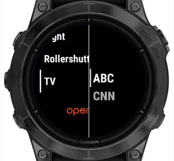

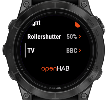

# Generic Switch
This variant is used for items that don’t fall under the previous two cases.
It supports multiple custom commands, defined either via:
  • mappings in the sitemap,
  • or command/state descriptions on the item (e.g., from a channel or metadata).
In the menu, the widget displays the current state as text:
  • If the state matches one of the mapped commands, the corresponding label is shown.
  • Otherwise, the raw state is displayed.
Tip: You can use an empty label in mappings if the item's function is self-explanatory from context.
Selection behavior:
  • If one command is defined, it is sent immediately when the item is selected.
  • If two commands are defined and one of them matches the current state, the other is sent immediately.
  • In all other cases, an action menu appears on the right side of the screen, allowing the user to select from the list of available commands. If the current state matches one of the commands, that command is not shown in the menu.
Example:
    Switch item=TV label="TV" mappings=[0="ABC", 1="BBC", 2="CNN"]

Example with Empty Mapping Entry:
Consider a garage door opener that acts as a toggle switch: sending an ON command triggers the gate to open or close, and the switch automatically resets to OFF after one second.
This can be configured in the sitemap like so:
  Switch item=EntranceGates_Operation label="Open/Close" mappings=[OFF="", ON="OK"]
  Text item=EntranceGates_Status label="Status"
In this configuration:
  • The switch typically stays in the OFF state, where the "Open/Close" label is sufficient.
  • When pressed, it sends the ON command, briefly displays "OK" as feedback, then returns to OFF.
Here’s how the interface appears when the switch is in the OFF state:

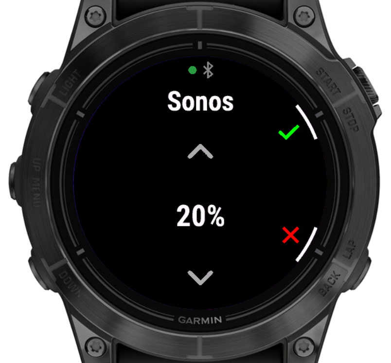

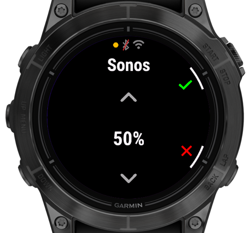

# Setpoint and Slider
The ➡️ Setpoint and ➡️ Slider widgets are numeric controls used to display and adjust the numeric state of an item.
When selected, both widgets open a full-screen view for choosing a new value, which is then sent as a command to the item.
The only behavioral difference between the two is the Slider widget’s support for the releaseOnly parameter (see below).
  • label: the label displayed in the UI.
  • item: the name of the associated openHAB item.
  • minValue: lower bound of the selectable range (default: 0).
  • maxValue: upper bound of the selectable range (default: 100).
  • step: interval between selectable values (default: 1).
  • releaseOnly: (Slider only)
    • With releaseOnly: The value is only sent when the dialog is confirmed. Cancelling leaves the value unchanged.
    • Without releaseOnly: Values are sent immediately as the slider is moved. Confirming keeps the current value; cancelling reverts to the value before the dialog was opened.
Important note: While the default step=1 is consistent with openHAB’s default, it often results in too many steps (e.g., 100 steps for a range of 0–100), which is impractical for wearable interfaces. Increasing step to 10 reduces the number of steps to 10, making interaction much more manageable.
  Slider item=Dimmer label="Dimmer" minValue=0 maxValue=100 step=10
Resulting UI:
  • The lower-left screenshot shows the slider on a button-based device.
  • The lower-right screenshot shows the slider on a touch-based device.
Note: Even button-based devices may support touch input, and on those, the UI reacts to both. On button-based devices, use up/down to scroll through the values, press enter (upper-right button) to confirm or back (lower-right button) to cancel. On touch-based devices simply tap the icons corresponding to the desired action or value to make a selection.

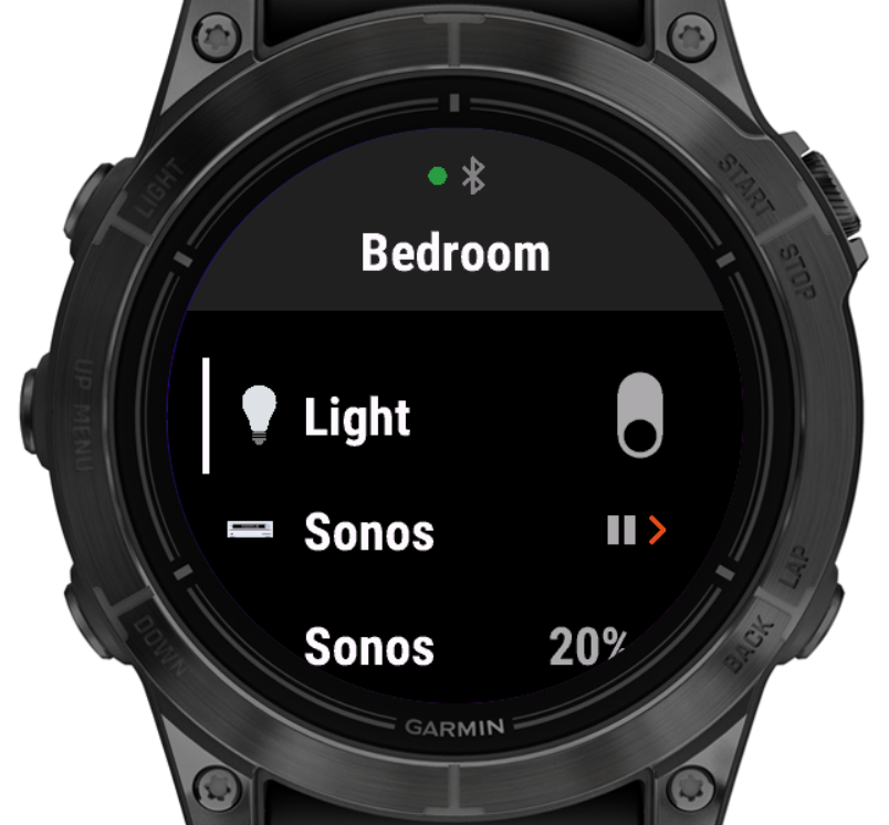

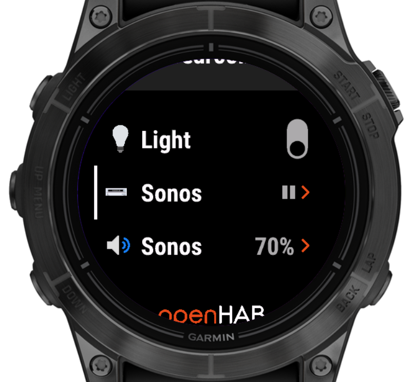

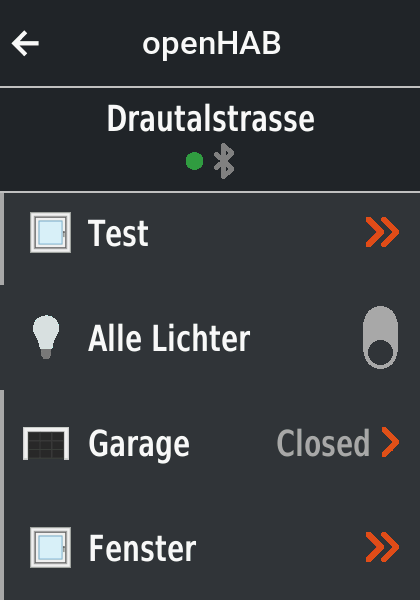

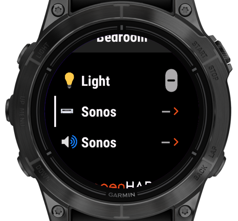

# Icons
For detailed usage and examples, refer to the sitemap icons documentation.
The Garmin app supports both the icon and staticIcon parameters, using a subset of the classic icon set. Where applicable, the app automatically selects an icon variant based on the item's state—for example, showing different icons for a light that is ON or OFF.
Below is a screenshot illustrating this behavior: The second menu item shows a filled lightbulb icon (indicating the light is ON), and the third item shows a state-aware rollershutter icon.
Tip: Even if you don't explicitly define icons in your sitemap, some may be applied automatically based on item metadata. To suppress this behavior, you can set the icon to an empty string in the sitemap: icon="".
Currently supported icons are:
  • batterylevel
  • blinds
  • door
  • garagedoor
  • humidity
  • light
  • lightbulb
  • lowbattery
  • poweroutlet
  • radiator
  • rollershutter
  • screen
  • slider
  • temperature
More icons can be added upon request. If you need support for additional icons, please post a request in the openHAB Community (opens new window).

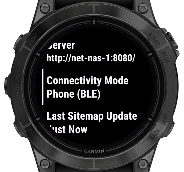

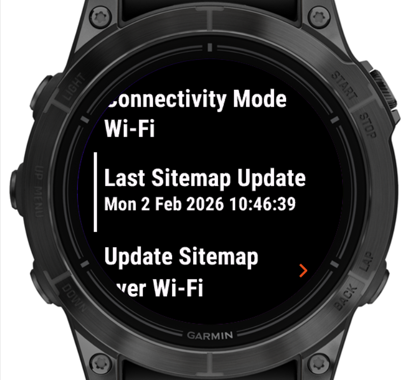

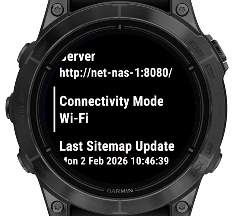

# Settings Menu
To access the settings menu:
  • On button-based devices, scroll down on the home screen and continue past the ⚙️ icon.
  • On touch-based devices, tap the ⚙️ Settings entry in the home screen menu.
The settings menu currently displays the app version and server URL. Additional features may be added in the future when the app evolves.

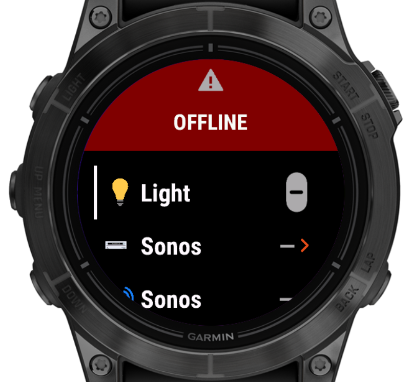

# How the App Handles Errors
The app distinguishes between temporary (non-fatal) and critical (fatal) errors:
  • Non-fatal errors trigger a toast notification at the top of the screen, allowing you to continue using the app.
  • Fatal errors display a full-screen error view, halting further use until the issue is resolved.
Non-fatal errors include:
  • Most communication-related issues when requesting the sitemap.
  • All communication-related issues when sending a command.
Note: Non-fatal errors related to requesting the sitemap will become fatal if they persist for more than 10 seconds.
Immediately fatal errors include:
  • Certain communication errors when requesting the sitemap, specifically:
    • Error -1001 (see below)
    • HTTP error 404
  • Errors encountered while parsing the sitemap.
  • Any other unexpected errors or exceptions.
Note: Even after a fatal error, the app continues querying the sitemap. If a response is successfully processed, it returns to displaying the sitemap.
