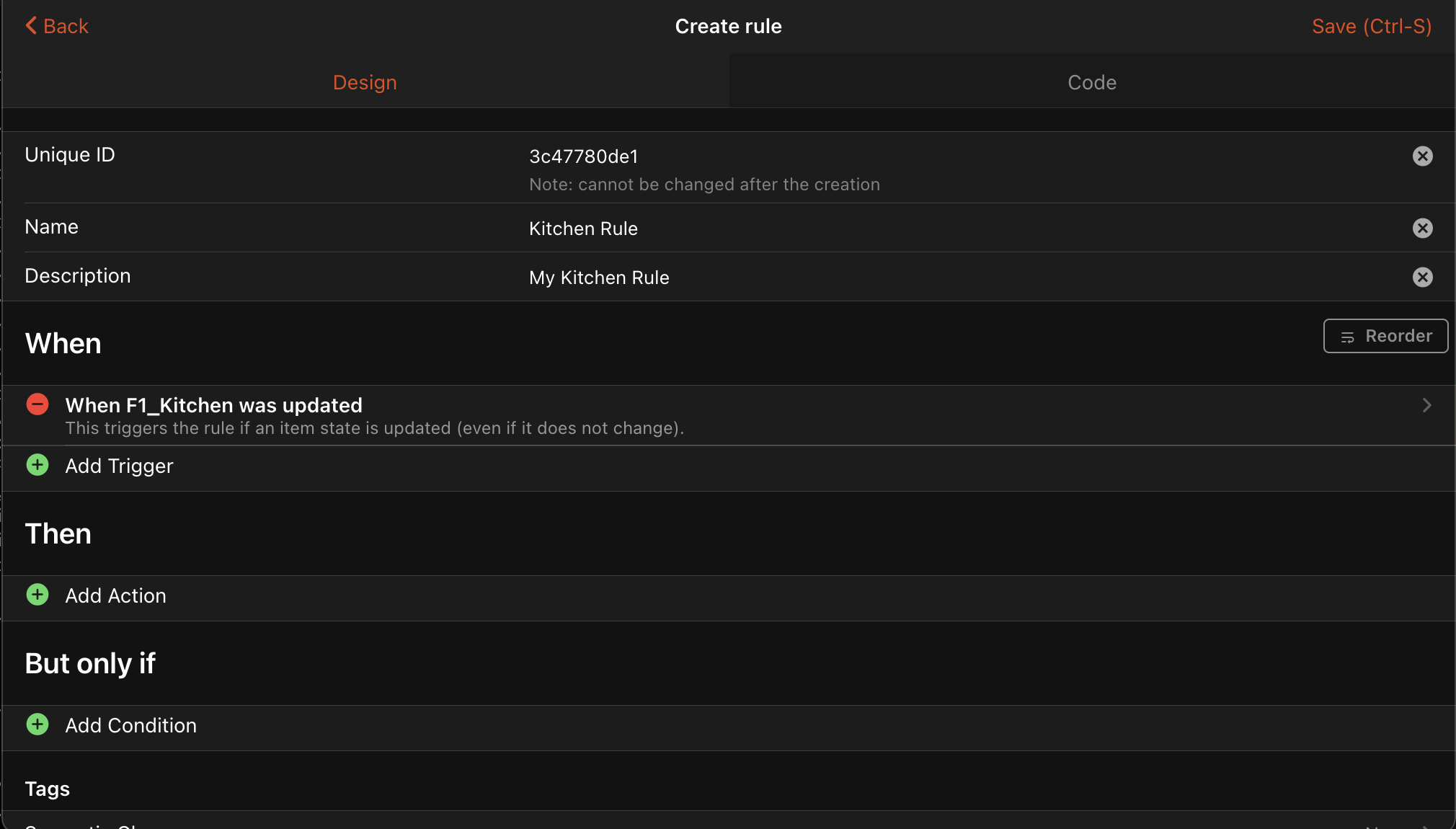

# Adding Triggers
Using the openHAB UI, first create a new rule and set a trigger condition.
# Adding Actions
Select "Add Action" and then select "Run Script" with "Ruby". This will bring up an empty script editor where you can enter your JavaScript.
You can now write rules using standard Ruby along with the included openHAB library.
