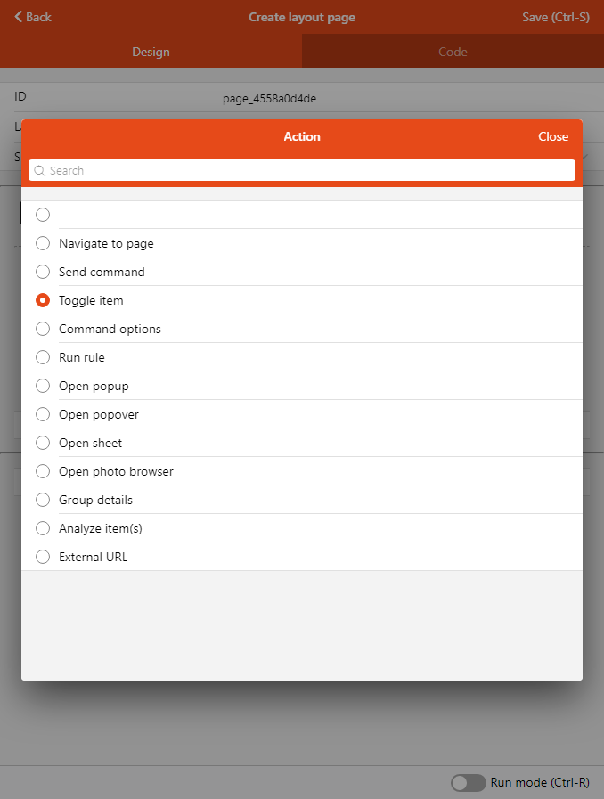

# Actions
When configuring a widget, you will encounter options related to actions (usually, when something is clicked or touched, but there might be several actions configured for a single widget, for instance, clicking on different parts or a long tap with a touch device); regardless, they will all have the same options:
These action options allow you to configure the interactivity within your pages, as well as the relation between them, in an extensive way. You can navigate to another page, display additional controls, popups and other modals, send commands to items every time a widget allows you to choose an action. For instance, a floor plan marker might either open another page in a popup, or toggle an item. Configuring the action type reveal more options in the action sheet:
# Types of Actions
Action | What it does |
Navigate to page | Opens a different Page with an optional transition. |
Send command | Issues a command to an Item. |
Toggle Item | Alternate an item between two states by sending commands (regular command if the item's state is different, or an alternative command if the state is equal to the regular command). Typically used with ON/OFF. |
Command options | Issues a command to the configured Item based on a comma-separated locally-defined list of options, or on the Item's State Description. |
Run rule | Trigger a rule directly. |
Open popup | Open a Page or personal widget in a popup which will be displayed fullscreen on phones and in a 630x630-pixel modal dialog on larger screens. |
Open popover | Open a Page or personal widget in a small "callout" comic-like bubble |
Open sheet | Open a Page or personal widget in a drawer appearing from the bottom of the screen. |
Open photo browser | Displays a full screen interface to view one of several images |
Group details | Used with Group items to open a popup with an automatically-generated list of the members of the group, represented by their default list item widget. For Groups with a base type like Switch, a standard card widget will also be shown for the Group itself. |
Analyze Item(s) | Opens the Analyzer window for the specified item(s) and period |
External URL | Open an external web page |
Set Variable | Set a variable that you can use in other parts of the page or widget. |
